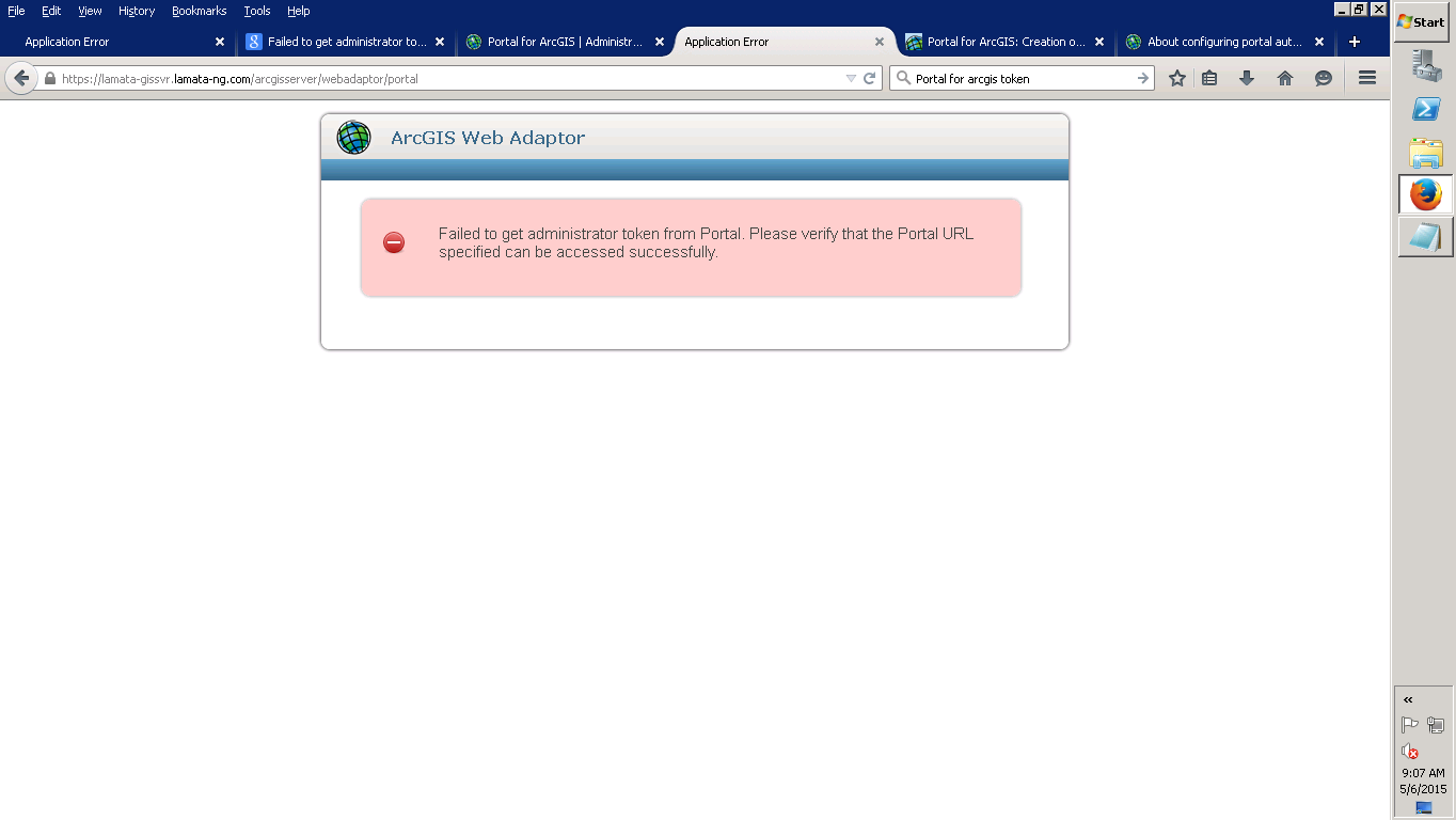

Hello,
I am try to configure a webadaptor with my Portal for ArcGIS and I keep getting the error message below. Can anyone tell me why? Particularly because I have done it (WebAdaptor configuration) before and it (the Portal) worked for several months, until last week when it just stopped working. While trying to trouble shoot, I uninstalled the webAdaptor, then reinstalled, that is when i get the error message.

Hi Lara,
Are you able to access Portal from the server you are trying to install the web adaptor on with the following URL:
https://lamata-gissvr.lamata-ng.com:7443/arcgis/home/

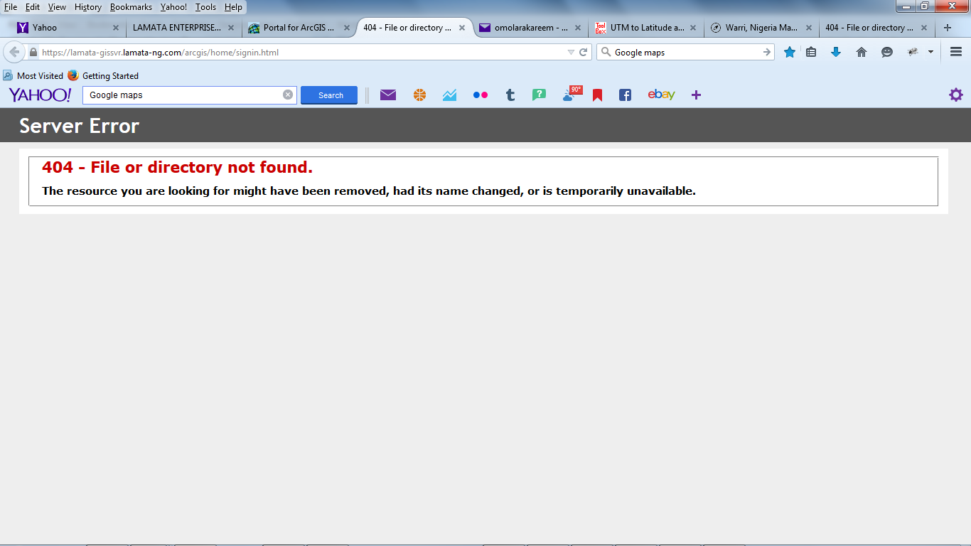

What is the error you receive when try to access Portal without using the web adaptor:
https://lamata-gissvr.lamata-ng.com:7443/arcgis/home/signin.html
OmolaraKareem
JakeSkinner
Esri Esteemed Contributor
It looks like you did not specify the port 7443 in your URL to bypass the web adaptor.  I would try Sephe suggestion of restarting Portal, then try the following:
OmolaraKareem
So sorry, I sent you the wrong print screen earlier. I did bypass the web adaptor. and I have tried Steven's suggestion, it didn't change anything either.

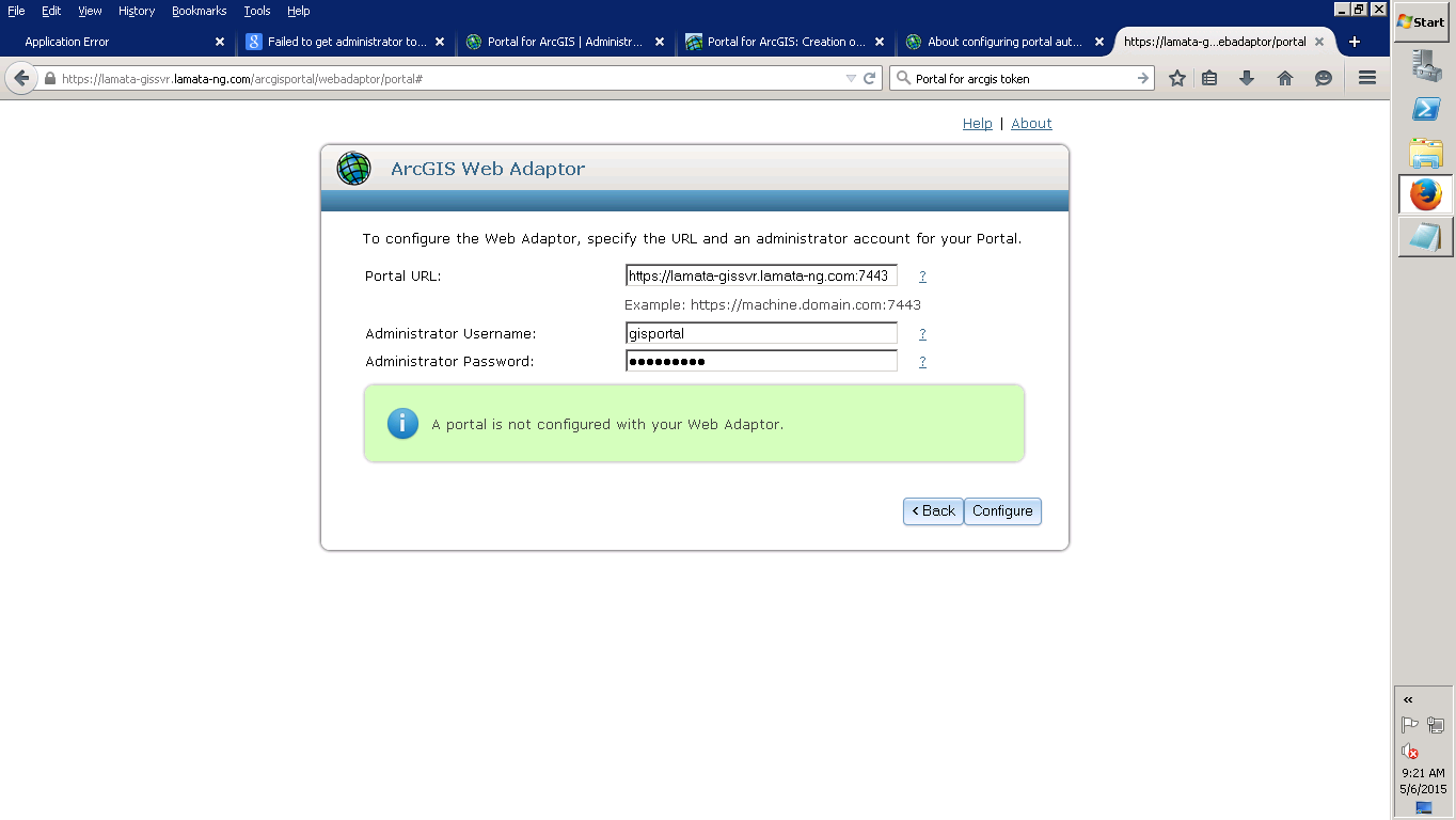

JayantaPoddar
MVP Alum
Hi,
Adding to Jake's suggestion,
The Portal can be configured by Web-Adaptor using an Initial Administrator account. Is "gisportal" an Initial Administrator?
