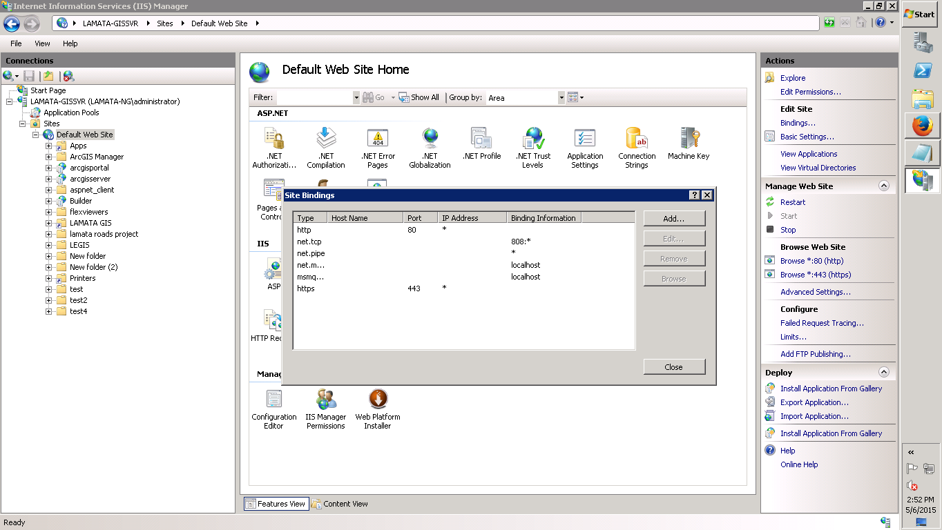

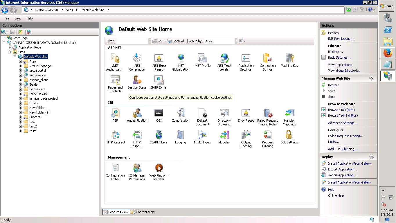

Could you take screen shots of what's in your IIS managers Default Web Site - Authentication and the Bindings.
OmolaraKareem
I hope this is what you need.
StevenGraf1

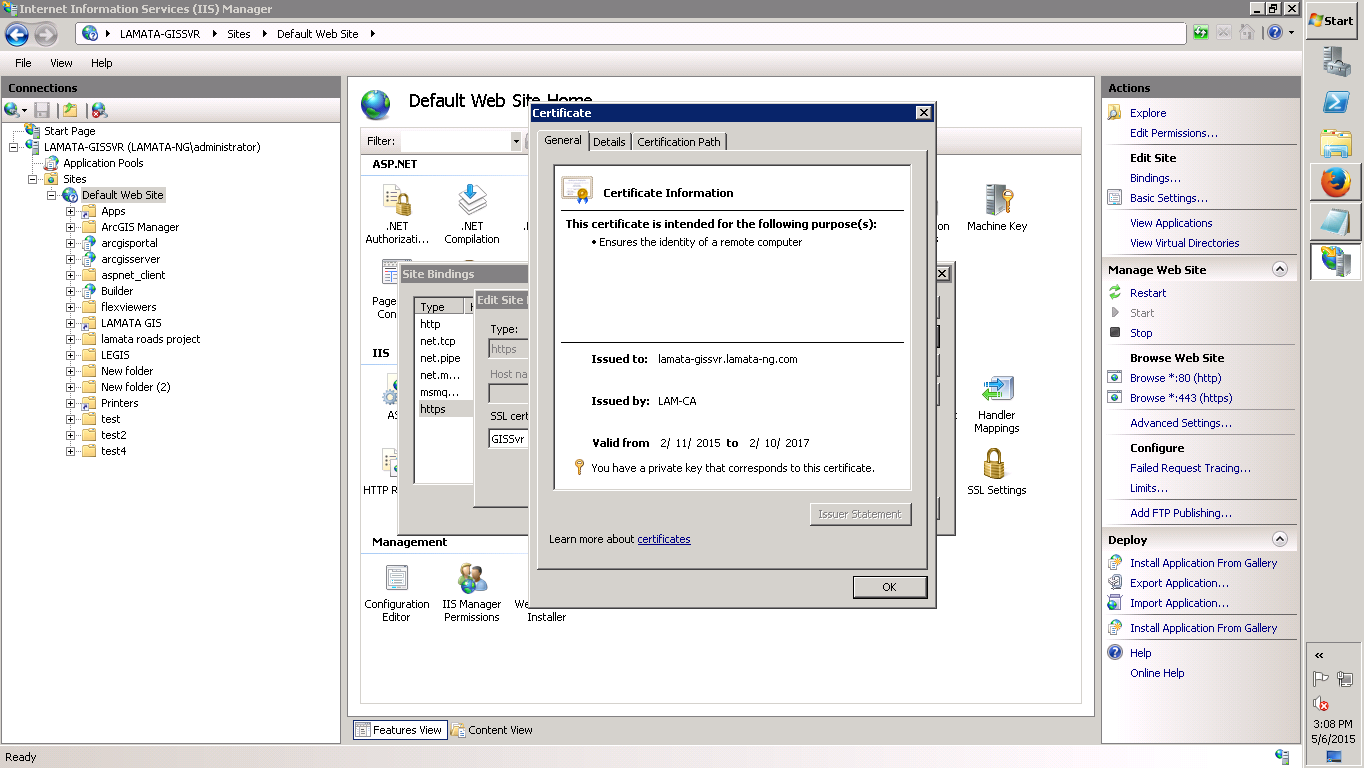

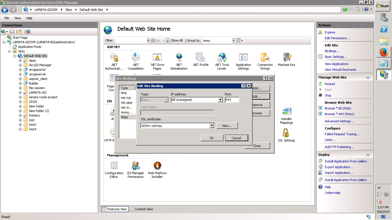

That's what looks like should be there.  Could you open the https binding (highlight and click edit) and check to make sure the ssl cert is there.
OmolaraKareem
StevenGraf1
Thanks, Everything looks fine there.
