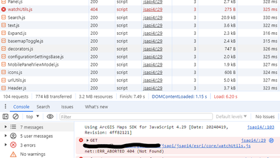

I believe it's because it's using Maps SDK for Javascript 4.29 and watchUtils is no longer there:
Did I miss anything ?

Yes, did you not see the console screenshot ? It's broken because watchUtils is gone.

WatchUtils was deprecated at version 4.24.  Deprecated classes are removed after three release cycles.  The last version to have watchUtils was version 4.27 and they were removed at 4.28.
ArcGIS Enterprise 11.2 was using 4.27.  ArcGIS Enterprise11.3 is the first version to not have them.
WatchUtils was replaced by reactiveUtils.  If the you have some custom functionality working with the watchUtils, you should rewrite that code to use reactiveUtils.
