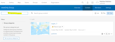

There is a workaround available to help in this situation. In the case that you have over 29 groups that are configured to only allow group owners and managers to contribute, you can share items to these groups from the group's content page.  I know that the likely more popular share item workflows happen from the Content or item details pages, but this is another workflow that does not seem impacted by this issue.

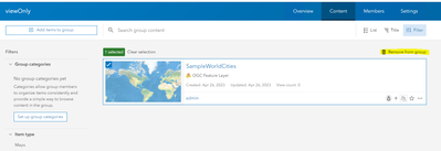

Just a note for the workaround that you are able to unshare items from the Group's Content page by selecting the item(s) and clicking the "remove from group" option on the page (pictured below). Although this workaround is not ideal, I want to make sure you have the tools to continue your work.
