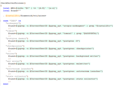

In Portal for ArcGIS version 10.9, the "error *** DIAG026: One or more core services was not started. [Warning]", is associated with the process validations. Using PG 12, the processes in ubuntu are different. It is a bug in the script "check_core_services.sh", the correct one is:
