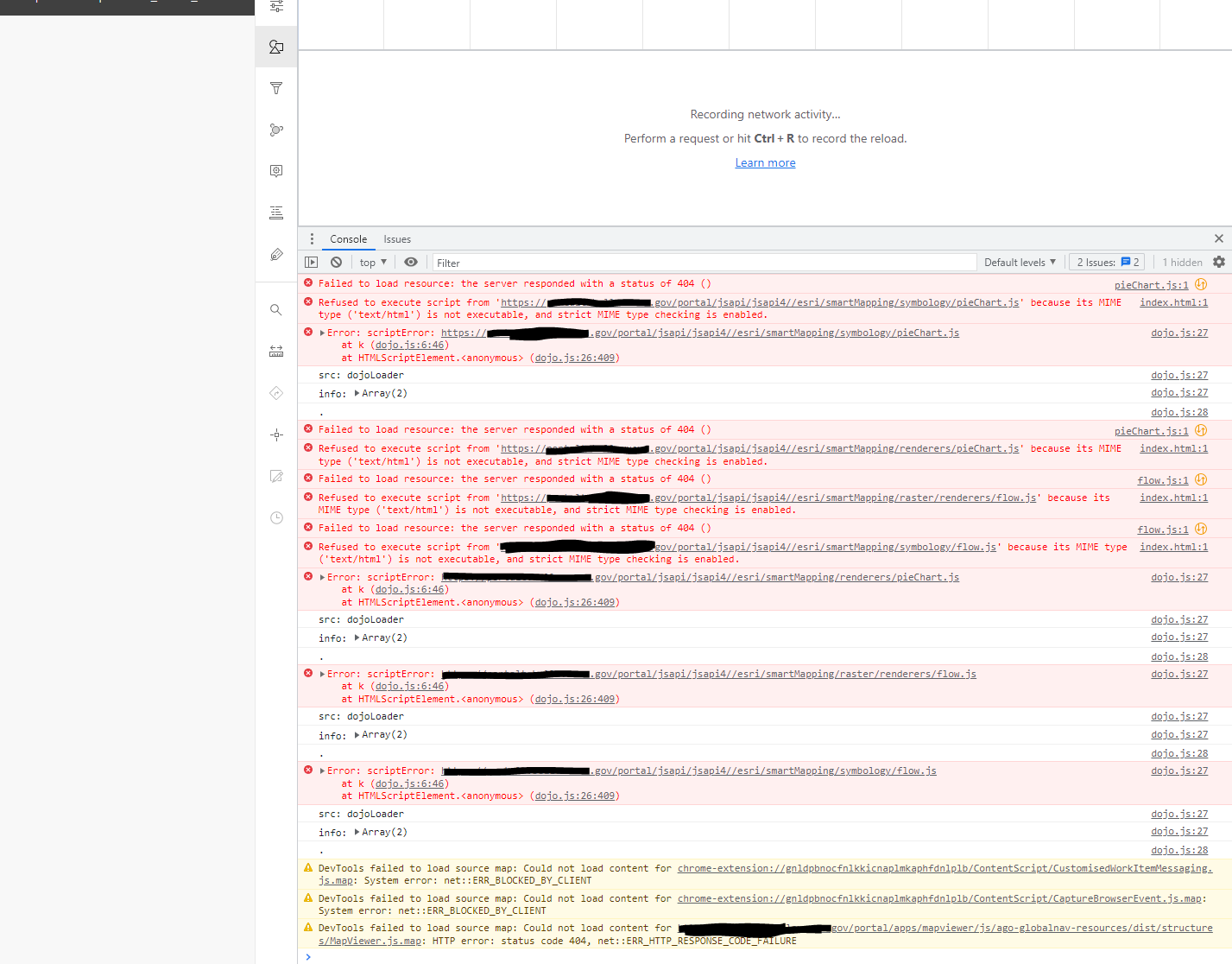

Happy Friday everyone,
Is anyone else running into an issue when a user, while using the new map viewer, clicks on the button for styles on a layer and runs into an error? It specifically manifests as....
Nothing showing up in the styles menu and in the developer window showing a bunch of 404 errors for pieChart.js and flow.js.
Infrastructure is Server 2019 w/ v10.9.1 with all current patches in place. Issue presented itself ~ yesterday evening time PST. Servers have been rebooted, etc. Firewalls were checked and nothing is getting caught there either.
The issue is presenting itself in both Edge and Chrome too.
JeffSmith
Yes, this is a known issue caused by the latest Portal Security Patch.  It has been logged under the following bug:
BUG-000157748 - After installing the Portal for ArcGIS 10.9.1 Security 2023 Update 1 Patch, Map Viewer's Styles panel fails to load and other panels (Filter, Clustering) subsequently fail to load.
We plan to have a version B of this patch available next week to address this.
JeffSmith
John_Spence
Thank goodness....thought I was going nuts. Thank you so much!
