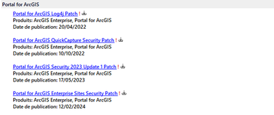

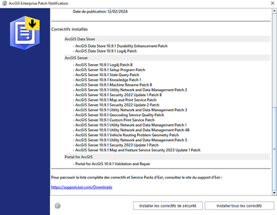

Yesterday I passed the repair patch on my impacted VM 1091. He uninstalled everything and it actually took a lot of time. I need clarification on the following points:
  • In the online article it states this:
    Step 4. You may now proceed with installing additional patches released starting in December 2023, either individually or using the ‘Install All Patches’ option.”
    So should we install the patches before December 2023? in my case 3 patches before this date.
Thank you very much for your feedback and allowing me to finalize the repair process.
Scott_Tansley
MVP Regular Contributor
Yes.  The validation/repair tool takes it back to a 'pure' install.
If you were fully patched then it should have removed ten patches.  Some of those have become 'cumulative' so you now only have to install 3 or 4, but they all need to be applied.
