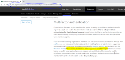

@JacobBoyle412  - Hi Jacob - Please see the highlighted text  in the attached pic (and at bottom).  Do I take this to mean that 3rd party SAML with multifactor authentication will work with AGOL?  But that the AGOL-based multifactor option won't work with a SAML login?   The text in the attached pic reads: "Multifactor authentication is not supported for SAML logins,...".  Sorry, I'm reading it both ways...Any help appreciated...

@NickHarvey: that explains the disconnect, I was speaking to ArcGIS Enterprise.
You should post this question in the ArcGIS Online channel, I was answering from an ArcGIS Enterprise perspective.

Hey Thanks Jacob, you were correct  - Got it answered in a reply to the post below and at very bottom link (below).  MFA can be done with AGOL using your own SAML basically.
