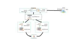

We are deploying ArcGIS Servers(On Premises- Due to Date Security Restriction). Previously we are using Load Balancer to connect both ArcGIS Server and not using any Enterprise Portal.
Now we have Enterprise Portal and ArcGIS Servers are federated with Portal(Only 1 Portal Server). we are planning to use load balancer and not able to found any esri document/help to add the load balancer.
2 ArcGIS Servers
1 Portal
1 Load Balancer
1 Postgres DB Request to all of you please suggest
SaurabhUpadhyaya
@JonathanQuinn can you please check
SaurabhUpadhyaya
proposed_arch.pngplease check this diagram
