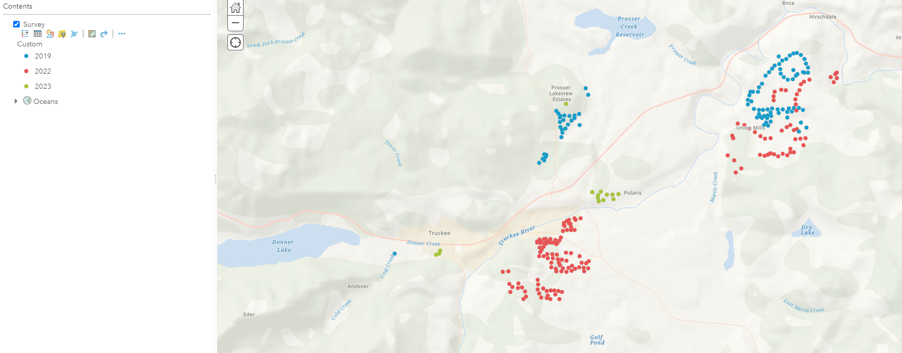

I am trying to symbolize survey points that were installed by certain year using Arcade expression:
var revegDate = Date($feature.Date)
if (revegDate >= Date(2022,01,01) && revegDate <= Date(2022,12,31))
return "2022"
else if (revegDate >= Date(2023,01,01) && revegDate <= Date(2023,12,31))
return "2023"
else
return "2019"
The expression doesn't return any errors but my points are not properly colored by year. I should have only one point installed in 2019 (blue). Majority of my survey points were installed in 2022 (243 of them). So, I should mostly see red dots. Only 14 points were installed in 2023 (green) which is the only year displayed correctly. See a snapshot below:
All data is being entered the same way - it's a download from a handheld device. Please don't advise ideas such as add another field and populate with proper year. I will be downloading this data on a regular basis. Hence, I want to avoid the manual process as much as I can.
Any ideas what's wrong with my expression or why my points are not symbolized correctly?

What type of field is $feature.Date? If it's a Date field, you can simplify this expression.
return Year($feature.Date);
One thing to be aware of with the Date function is months are 0-based, so to create a date for January 1, 2023, you would use Date(2023,0,1). The result of Date(2023,12,31) is January 31, 2024.

Thank you. Thanks for letting me know about the months being 0-based. Didn't know. I adjusted the dates and now my points are being correctly displayed.
Thanks.
