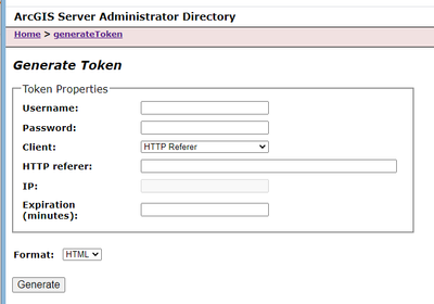

Thanks for the standalone getToken sample.  Unfortunately that script is failing with the same error message.  If I wanted to just use the generateToken call from a web browser with the following inputs how would that relate to the inputs in the python script as they appear different to me?  I see username and password as parameters but I do not see http referer or expiration in the token script.
LongDinh
Refer to the REST API notes on ways to request tokens here: https://developers.arcgis.com/rest/users-groups-and-items/generate-token.htm
