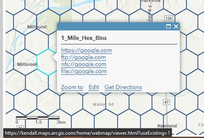

You can't link to a local filepath form Portal, unfortunately. Anything besides https://... is going to be automatically re-written as the URL you are currently at.
Preview of destination URL for FTP link.Preview of destination URL for FTP link.
We have an internal viewer where our users want to have the same capability. The best we've been able to do is provide the filepath string that they can copy and paste into their file explorer address bar.
As far as I know, the only way to access local resources like files with a clickable link is to use desktop software.
