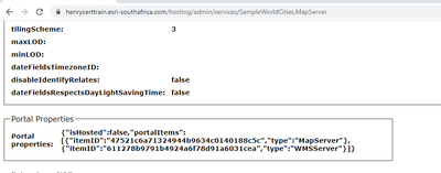

Do you ever add the services with the url for example https://henrycerttrain.esri-southafrica.com/hosting/rest/services/folder/name/FeatureServer/0 ?
I have seen before that only the item with the itmeId controls the sharing.
Can you verify that the itemId in ArcGIS Server matches the ItemId in portal it is located under admin
https://henrycerttrain.esri-southafrica.com/hosting/admin/services/SampleWorldCities.MapServer
