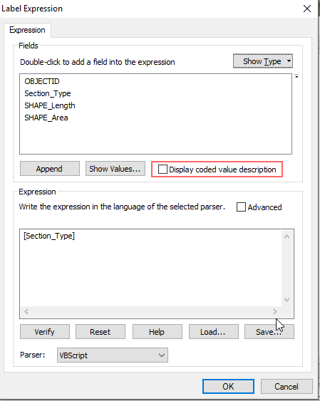

So, I've got a [MATERIAL] field that has a coded value domain associated with it in the geodatabase.  The domain is like:
Code    Description
CI           Cast Iron
AC          Asbestos Cement
How can I get the code value to use in my label expression?
Tags (2)
6 Replies
PrasadRao1
Uncheck "Display Coded Value Description"
http://forums.esri.com/Thread.asp?c=158&f=1696&t=296653

Unfortunately that only seems to work in attribute tables, not in labels.

This action resolved the problem.
DavidForbuss1
Yes, that worked thank you!
