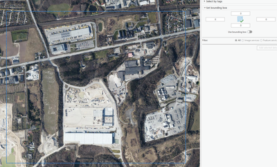

The use case for my colleagues is e.g. a construction site. For whatever reason the colleague has to take all the existing buildings in the vicinity into consideration and she/he knows that we offer building polygons as a nation-wide feature layer at our portal.
The colleague request the data through an addin as a feature service layer. The area of the mapview is at that point covering not only the closer area around the construction site, but actually the whole municipality (or worse: the whole country).
It takes now a while to get, and visualize all the unnecessary building polygons, and the they clutter the mapview.
To avoid exactly that, the colleague will most likely then go to the portal, define a bounding box and extract the data through the portal, to store the data locally, where they will be outdated after a short while. Of course, buildings might not be the best example, but you get the point.

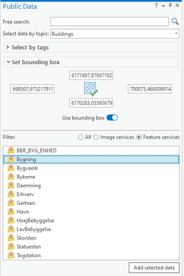

To provide my colleagues with an easy way to retrieve data from the portal, without knowing to much about the portal I wrote an addin, offering a little ui, where the user get all the publicly available geo-data (provided through our portal) . Here, the user has the possibility to use a map tool to define a bounding box, which I would like to use to limit the requested service layers to.
Hence, the question about adding a &extent=minX, minY, maxX, maxY into the uri, when creating the service layer in Pro.
I am aware of the possibilities the user has, once the data are in the map. What I want to do is to limit the data before they come into the map, and to avoid redundant, and/or outdated data laying around in all sort of project folders.
