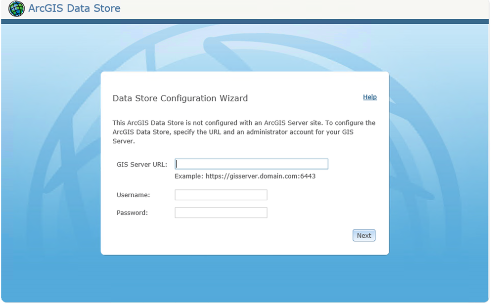

Hi @ABishop, thanks for the information however when I checked if we have datastore installed it gives the following message:Screenshot 2021-11-23 at 11.05.33 AM.png
Does this mean that datastore is not installed? What happens in this case? Where would the ArcGIS server store the geotiff?

Looks like you will have to configure the data store.
Not sure what version of ArcGIS Server you are running, but here is an information article from ESRI's website, just change the version you are on.
https://enterprise.arcgis.com/en/data-store/latest/install/windows/create-data-store.htm

You may need to configure a raster store (folder location) where the ArcGIS Enterprise can place the imagery files; https://enterprise.arcgis.com/en/portal/latest/use/add-items.htm#ADD_DATASTORE
https://enterprise.arcgis.com/en/portal/latest/use/create-imagery-layer.htm
Then you should be able to add those items to Portal. It will copy the imagery files to that datastore location created above.
The data store image above is for hosted vector data in ArcGIS Enterprise.
