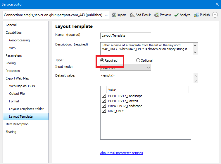

1) When preparing to publish I set the parameters in the Service Editor to "Required" instead of "Optional"

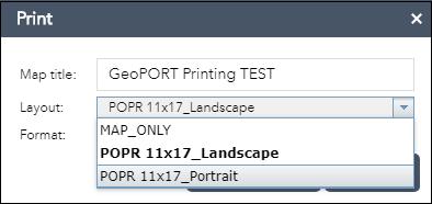

Once done I now see my other choice for a map template available as a custom print service in the web app:

Mark_Hotz
I made a mistake and took a screen shot of the wrong process in the Service Editor.  I didn't set the Format to "Required" as per above...I set the choice list in the Layout Template as "Required" :-).  Sorry about that:
