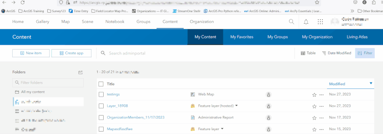

 I had thought I fixed the issue with the redirect_uri, but it seems to continue in other places. I found that when viewing a map, and clicking on the menu button and then home, it sends back to my internal portal URL, why could that be, and could I change it?
Enterprise 11.1 | Apache 2.4
When this occurs, I also am unable to access Notebooks, and any content as a redirect_uri appears, here is what it shows:
If anyone has any ideas, I'd greatly appreciate it, I assume this is why I'm not able to access the Organization settings through this as well.

Yes, that url that you highlighted in your screenshot should definitely be your reverse proxy url.  It should not point to your internal url.  One way to confirm that your WebContextURL setting is being read properly is to access the following url (adjusted to point to your portal):
https://arcgis-reverse-proxy/context/sharing/rest/portals/self?f=json
You don't need to be logged in; you can access this anonymously.  Search for "portalHostname".  The value should match what you specified in the WebContextURL parameter (the https protocol is not included).  It is what the Map Viewer should be using to create that link for the Home button.

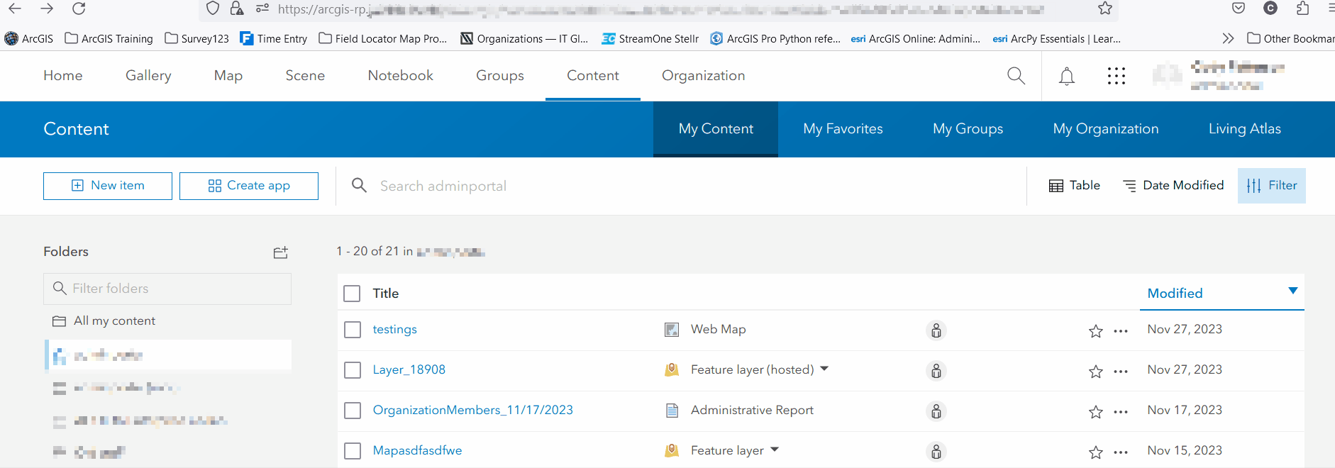

Oddly enough, I decided to just attempt and place the regular URL that I use into the web context url, and after about 15 minutes my Portal environment came back up and I am now able to see my Organizational settings and Licenses, but at this point, the Home button is still redirecting to the internal URL of the portal. I'm curious if this was possibly missed during an implementation when looking at the inspect console of the home button while on the reverse proxy, this is what I see, it should be like https://arcgis-reverse-proxy/ or something similar:
