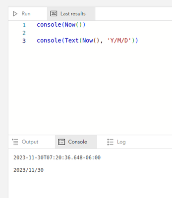

Using Text is definitely the way to do it. When you say it doesn't work at all, what does it do? Does it return something other than the timestamp?

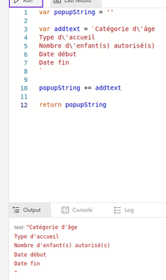

Also, consider using template literals for long strings. Inside of a backtick string, you can just use a regular newline, and the expression will be a lot simpler and cleaner to look at:
var popupString = ''
var addtext = `Catégorie d\'âge : ${f.LB_COD_CAGR}
Type d\'accueil : ${f.TYPE_ACCUEIL}
Nombre d\'enfant(s) autorisé(s) : ${f.NB_ENFANTS}
Date début : ${f.DT_DEB_AGR}
Date fin : ${f.DT_FIN_AGR}
popupString += addtext
 I don't have your attributes to test it, but without them, you can still see the newlines coming through.
