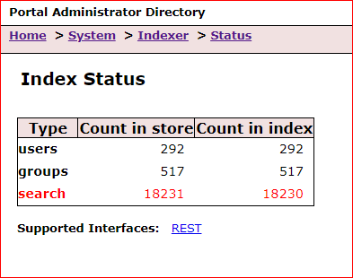

portal Index shows all groups.
However all groups are available. The groups are listed when a site hub is shared.

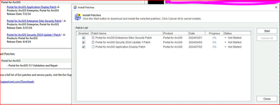

Hi @A_Wyn_Jones we haven't installed any patches yet: I see 4 patches available for portal 11.1
We have a HA deployment with 2 portal VMs and got couple of questions:
1. What is the order of the patch installation?
2. Do I need to install all patches listed below?
2. Do I need the validation and repair tool run first?
3. If Security 2024 update 1 patch is applied, then is it necessary to apply Sharing Patch (as it is also included in the security 2024 patch)?
Many thanks Thomas
A_Wyn_Jones
Hi @Thomas_Puthusserry,
The order of patch installation is done for you via the "Install All Patches" button.
You need to run the validation and repair tool first before clicking Install All Patches
The sharing patch will be installed before the Security 2024 patch
You can automate this patching using the command line tools provided by Server, Portal or Datastore:
https://enterprise.arcgis.com/en/server/latest/install/windows/check-for-software-patches-and-update...
Keep in mind patching requires downtime of the component being patched.
Hope this helps!
