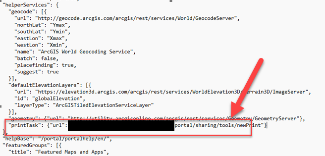

Does anyone know how is the properties.json file generated that lives in the shared content folder for ArcGISPortal?
The exact file location is in ....\arcgisportal\content\items on your shared content directory, whatever that you may have defined during your arcgis portal installation. Could be in your server machine or could be in a shared network drive as well.
In that properties.json file, under helperServices section, there is a printTask url and that is pointing to a url which we did not update anywhere. how is this file getting that url there?

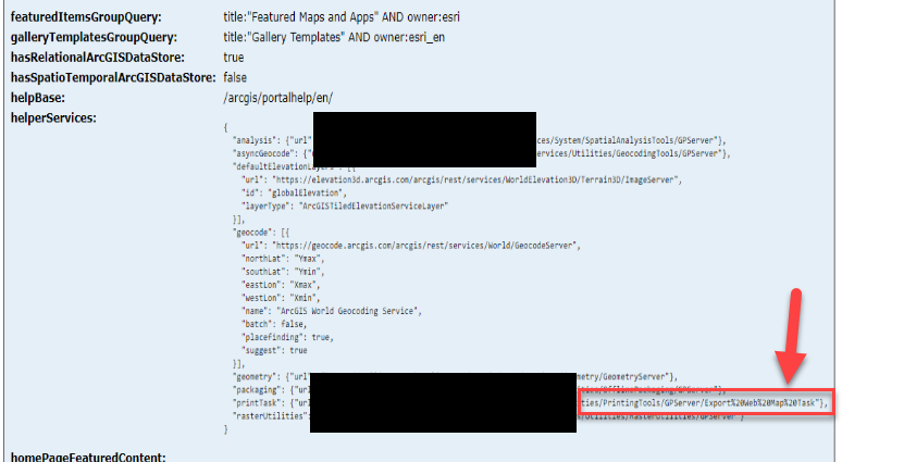

If we look at the portal sharing, we see a different print task url that we identify.
any ideas? any seasoned experts of arcgis enterprise care to share and help me understand better please?

You've discovered the Portal for ArcGIS default print task URL in your properties file which is used by Portal in a unfederated state - it is recommended by the Portal security scan to disable this once the Portal has been federated with a ArcGIS Server:
https://enterprise.arcgis.com/en/portal/latest/administer/windows/scan-your-portal-for-security-best...
You can disable the default print service in Portal admin > System > Properties - here's the syntax:
https://developers.arcgis.com/rest/enterprise-administration/portal/system-properties/#:~:text=domai...
In your second screenshot, you can see that the Portal has configured itself with the ArcGIS Server default print task - this is done during federation.
