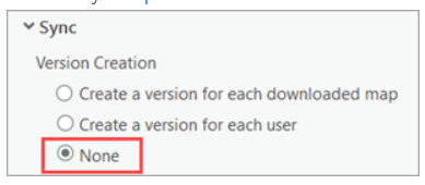

Thank you for your answer. Judging by the link you provided me, I am in the 1st scenario (archived but non versionned data, one-way synchronization). I tried to re-publish the FeatureServer because I wasn't aware of this publication option :

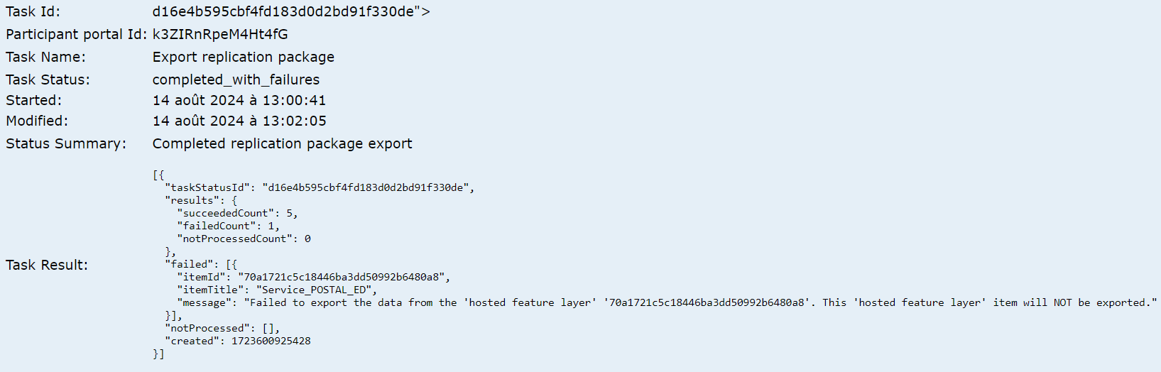

but unfortunately this had no effect, I still have the same error message in the portal logs :
The FeatureServer uses data from a geodatabase, so I don't know why the log message refers to a 'hosted feature layer'.
