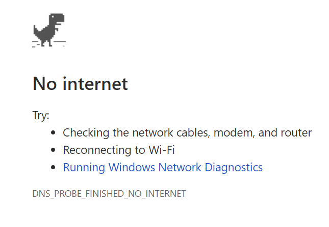

Also, there is the big problem. When I also try to access to Portal from outside the VM, if I write https://namemachine.domain.int/portal/home/organization.html or https://namemachine.domain.int:7443/portal/home/organization.html or https://XX.XX.XX.XXX:7443/portal/home/organization.html there is the result :

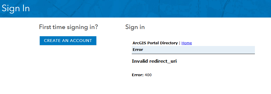

and few seconds later this ->
If i write this https://XX.XX.XX.XXX/portal/home/organization.html this is the result :

Looks like there are a number of network related problems. First, your machine name isn't resolving even within your internal network. DNS should be associating the IP address, of the Enterprise machine (10.0.0.1, let's say), to the hostname, (enterprise.domain.com, let's say). Outside of the network, your machine needs to be publicly accessible and you need to assign a hostname/domain to the public IP address, that'll give you access to the site from outside of your network. Unfortunately, none of those problems are something Esri Technical Support or our documentation will help with. Those problems should be addressed by your IT staff.
The invalid_redirect_uri problem is due to the fact that Portal is configured with a certain set of hostnames that can sign into Portal, for example enterprise.domain.com or *.domain.com. When you reach the Portal home page through those hostnames, there shouldn't be a problem. Portal doesn't know what the IP address is and it doesn't match the hostnames it's configured to allow a sign in from, which is why you receive the invalid_redirect_uri error.
