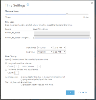

I have several time-enabled datasets with a start and end time.  These datasets are at various temporal resolutions i.e. Hourly and spanning several weeks.
The Map Viewer time slider allows the user to specify date ranges and the granularity of the slider intervals e.g. show only 10 July - 11 July with 1 hour intervals.

You can adjust the time slider and multiple time-enabled layers in the Time Slider settings in a web map.

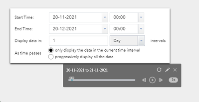

We using same Customized Time Slider widget in our organization.
It's using to manage time extent(Start Date, End Date) on Field Simultaneous Activities Map. Tested for WAB from 2.8 to 2.19 and also for Portal for ArcGIS 10.6
Attached to this post
