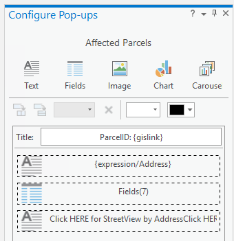

I have come across various issues regarding popups working correctly in Pro but when published to Enterprise 10.7.1, the popup configuration does not come through.
I tested using custom popups. I used 3 different objects to create the popup, first being a text with a custom expression, second I turned on a few fields, third was a text object with more custom expressions.
Works great in Pro.

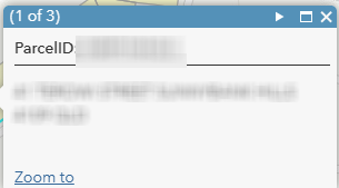

custom_popups.pngcustom_popups_pro_blurred.pngWhen published to Portal, only the 1st object (text values) gets passed through for the feature service. With the image service, nothing passes through.
feature servicefeature serviceimage serviceimage service
Is this a known limitation with Portal?

Hello,
I took a look at that defect you mentioned, and it seems that this is a known limitation of web apps built using the 3.x version of the ArcGIS API for Javascript. The old ArcGIS Online map viewer, as well as the default Portal Mpa Viewer, are built on vesion 3.x. It looks like in 4.x, which is what hte new Map Viewer Beta uses, the issue is resolved.
Can you try loading this pop-up in the ArcGIS Online Map Viewer Beta? If you are using Enterprise 10.8.1, you can download the Beta here: https://www.esri.com/arcgis-blog/products/arcgis-enterprise/announcements/map-viewer-beta-in-arcgis-...
