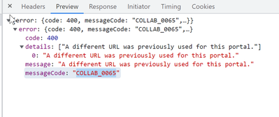

Hi, trying to set up collaboration between enterprise 10.9 to ArcGIS Online and coming across this error. The enterprise previous had domain https://gis.xxx.com and we changed it to https://gis.yyy.com/ . We updated all the urls used in the federation and items. Everything appears to work. However when I attempt to create this collaboration I get the error below. Any way we can fix this?
Edit: I got this error when trying to accept the response from arcgis online.

Thanks @MehdiPira1  for your reply. Unfortunately this is a fresh collaboration, configured from scratch. I have removed all previous collaboration configuration.

For anyone experiencing this issue, it is likely due to an incorrect, or otherwise different portal URL having been used in the past for a Distributed Collaboration. The AGOL database logs that "incorrect" URL believing it to be valid, and thus recognizes no other portal URLs.
The best resolution for this issue is to create a technical support ticket, as this back end change to AGOL is only able to be done by Esri.
