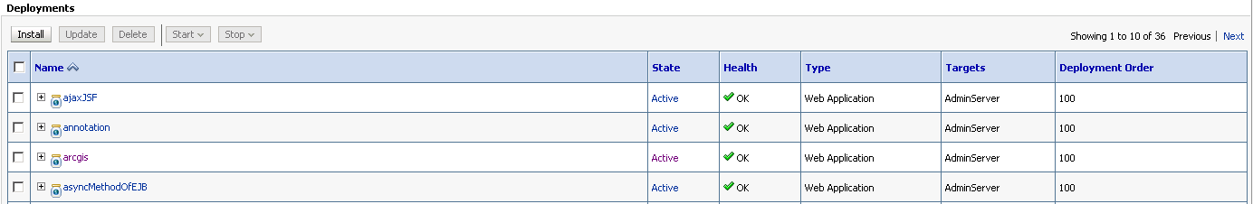

Also, I have deployed Web Adaptor on WebLogic.

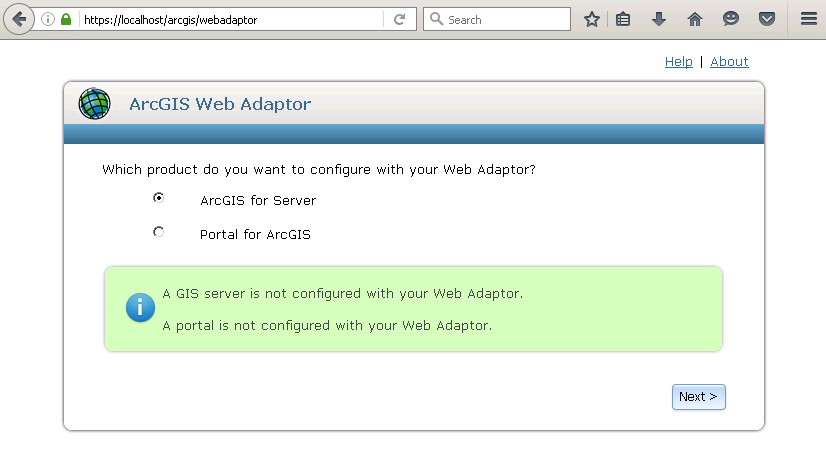

If I try to access the Web Adaptor via https://localhost/arcgis/webadaptor or http://localhost/arcgis/webadaptor​, I can able to see the configuration page (pasted the screen shot).
