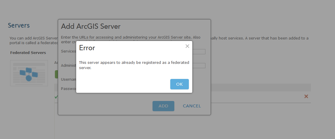

when i try to federate more than on servers the following error comes

JonathanQuinn
Esri Notable Contributor
It appears as though you're providing the URL to a server you've already federated.  The URLs must be unique.  For example, if you federate a server that uses https://myserver.domain.com/server as the Services URL and https://myserver.domain.com:6443/arcgis as the Admin URL, that would point to a single site.  Each site should have unique URLs that will be used to federate.  If you're 100% sure that the Server isn't federated, but the Portal thinks it is, then that's another problem.
sajjadsaeed1
Deactivated User
we are providing the two unique URLs as we have to federate the two different machines.the both URLs are following.
Services URL: https://gismachine1/arcgiswebadaptor
Administrative URL of First Machine(Portal Machine): https://gismachine1:6443/arcgis
Administrative URL of Second Machine: https://gismachine2:6443/arcgis
after federation of any one machine we are unable to federate other one.
JonathanQuinn
Do you have an active/active configuration or are they part of the same site?  Considering you're using the web adaptor, I assume they're in the same site.  If so, there's no need to federate both machines that participate in the site, you simply federate the site.  Both machines will recognize they're federated.  If you've set up your servers so they're redundant, then you'll want to federate using a URL that can be aware of the health of the machines for example:
Services URL:  https://gismachine1/arcgiswebadaptor - this URL is for users to reach the Services in web applications.  Admin access can be disabled.
Admin URL https://gismachine1/adminwebadaptor - this URL can be used as the admin URL for federation.  It's registered with the ability to reach Manager and the Admin API through the web adaptor.
The admin URL can also be a third party load balancer if you want to go that route.
