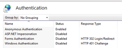

As per the article is Authentication on your server web adaptor currently set at Anonymous Authentication Enabled and Windows Authentication Disabled?
Is your portal web adaptor setup in reverse to your server web adaptor in terms of Anonymous and Windows Authentication?
MKF62
Yes - here are the setting in IIS, both the Portal and Server web adaptor have these settings:

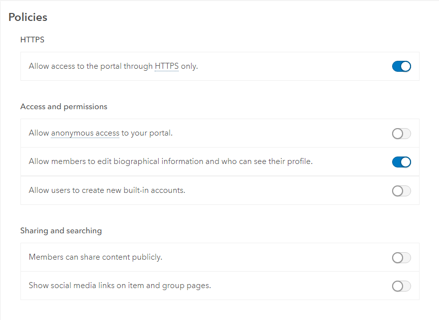

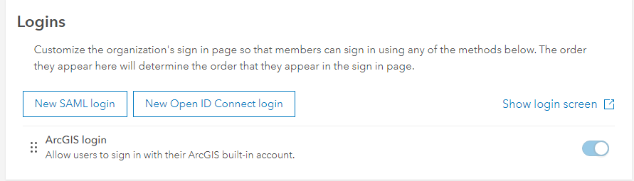

On Portal these are the login settings I could find. My users use ArcGIS Built-In accounts, they do not login to the Portal with Windows credentials:
