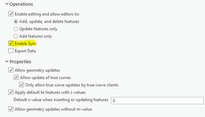

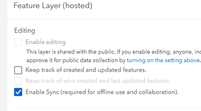

 I went into the service's Settings and enabled Sync, as I know this setting can add GlobalID fields if they are not already present.

Toggling that setting back to off does not change the applyEdits property to False, however. I would suggest toggling that setting off and on and see if it changes for you.

I have only seen the option to enable sync when publishing the feature service. I haven't needed to enable that option for other feature services that I have published but I did give it a try. Unfortunately, the applyEdits property was still set to false only for the Structure Junction layer while all other layers had the property set to true.
