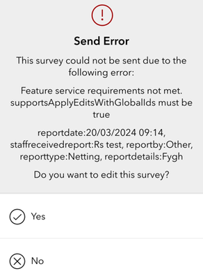

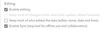

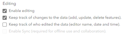

I have a hosted feature layer in Portal Enterprise 11.1 and I need 'Keep track of changes to the data (add, update, delete features)' to be turned on to use webhooks and I need 'Enable Sync' to be turned on otherwise users get an error on supportsApplyEditsWithGlobalIDs.
However when I turn one on the other is greyed out? Is there any way around this?

https://enterprise.arcgis.com/en/portal/latest/use/manage-editing-hfl.htm
This setting is not available if the feature layer has sync enabled.
If you enableKeep track of changes to the data (add, update, delete features), you cannot subsequentlyoverwritethe hosted feature layer.You also cannot subsequently enable sync on the layer ifKeep track of changes to the data (add, update, delete features)is enabled.

Thanks for the reply, unfortunately my issue is slightly different. I've no problem ticking on the Change Tracking and it's visible in the capabilities.
However with 'Enable Sync' needing to be turned off to allow change tracking, users can't make any submissions through Survey123!

Funny thing is, I don't need sync, I'm not working offline or distributed collaboration, but if I turn it off I get this error.
I think Survey123 won't work with Enterprise unless sync is enabled, regardless if it's needed.
