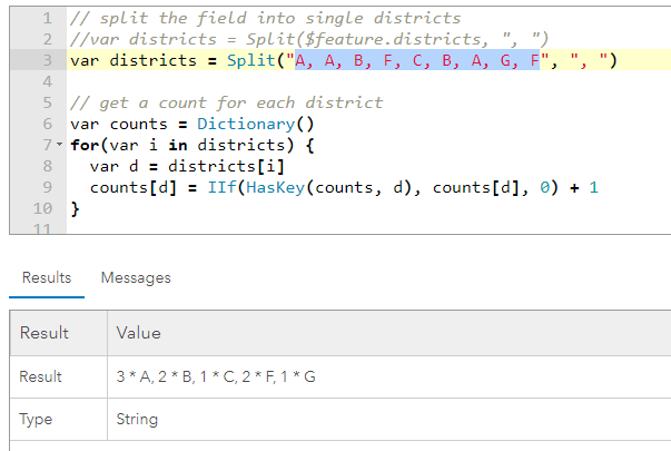

JohannesLindner
MVP Alum
Something like this?
// split the field into single districts
var districts = Split($feature.districts, ", ")
// get a count for each district
var counts = Dictionary()
for(var i in districts) {
  var d = districts[i]
  counts[d] = IIf(HasKey(counts, d), counts[d], 0) + 1
// combine districts and counts
var output = []
for(var d in counts) {
    Push(output, counts[d] + " * " + d)
// return
return Concatenate(output, ", ")
Have a great day!
