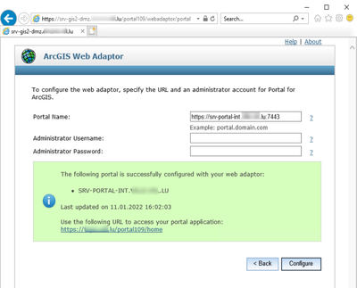

I created a second machine and installed my Portal and Server Web Adaptors redundantly. The first machine uses IWA and the second uses anonymous authentication. Internal users are directed to the first server and external users are sent to the second server, but all of them use the same WebContextUrl as a point of entrance.

As You can see above in my screenshot, I indeed managed to install both Portal WA on different machines pointing to the same Portal.
In my Enterprise 10.9.0 environment, the existing WA was not overwritten. This is, what happened to You?
