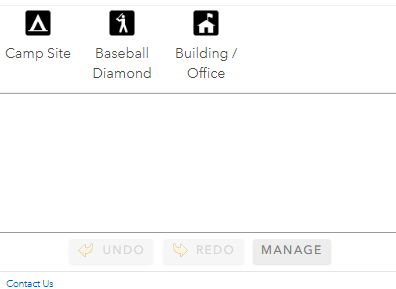

JeffLegato1
I don't see a Manage button either. I would like to remove one of the templates in my map. I wonder if it's only available with hosted data?
KelseyMills
While this is an old thread, I had the exact same issue and was able to find a way to make it work. We are using an Enterprise portal and do not have the newest updates to the new Map Viewer which reflect the 2/2025 rollout of the ability to manage templates.
I am also an admin in our organization and was unable to get the Manage button to appear in Map Viewer and Map Viewer classic. What worked was to 1) go to the item details page of the hosted feature service, 2) Where it says 'Open in Map Viewer' click the dropdown arrow and choose 'Open in Map Viewer Classic with full editing control', 3) Choose Edit from the options ribbon in Map Viewer Classic. The Manage button should now appear at the bottom of the screen. This is all assuming Editing has been turned on for the layer in settings
