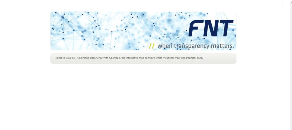

Currently we have an unfortunate situation to one of our clients, where, after the migration of the Esri's system to the HCI, the portal simply wont load after logging in (please refer to the picture below)
We have tried restarting all the services to no success. Can someone please help us? Thank you.

Please close this topic, as I have found that this is related to the Chrome browser. I have tried again using Mozilla to great effect.
Apologies. Thank you.

You may want to look at installing this patch for Chromium based browsers: https://support.esri.com/en-us/patches-updates/2024/portal-for-arcgis-application-display-patch
