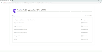

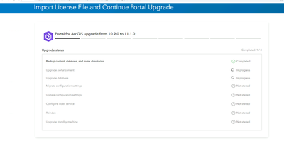

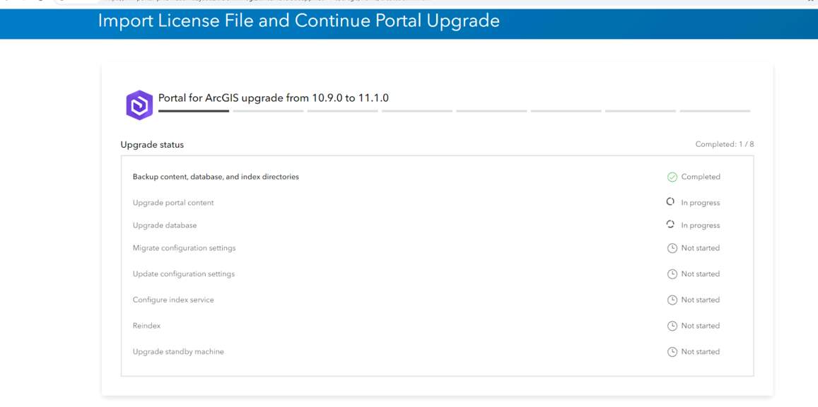

3. Proceeded with Upgrade option in Portal Primary, and saw steps 0/8 appearing.

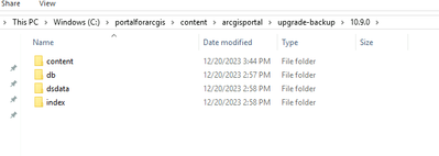

Monitored the log files and contents changes in both machines and found something interesting: The backup content, database and index directories actually happened in the secondary portal machine (Standby) not in the primary portal machine. This created a new folder called upgrade-backup /10.9.0. It also upgraded the database in standby.

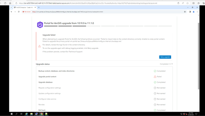

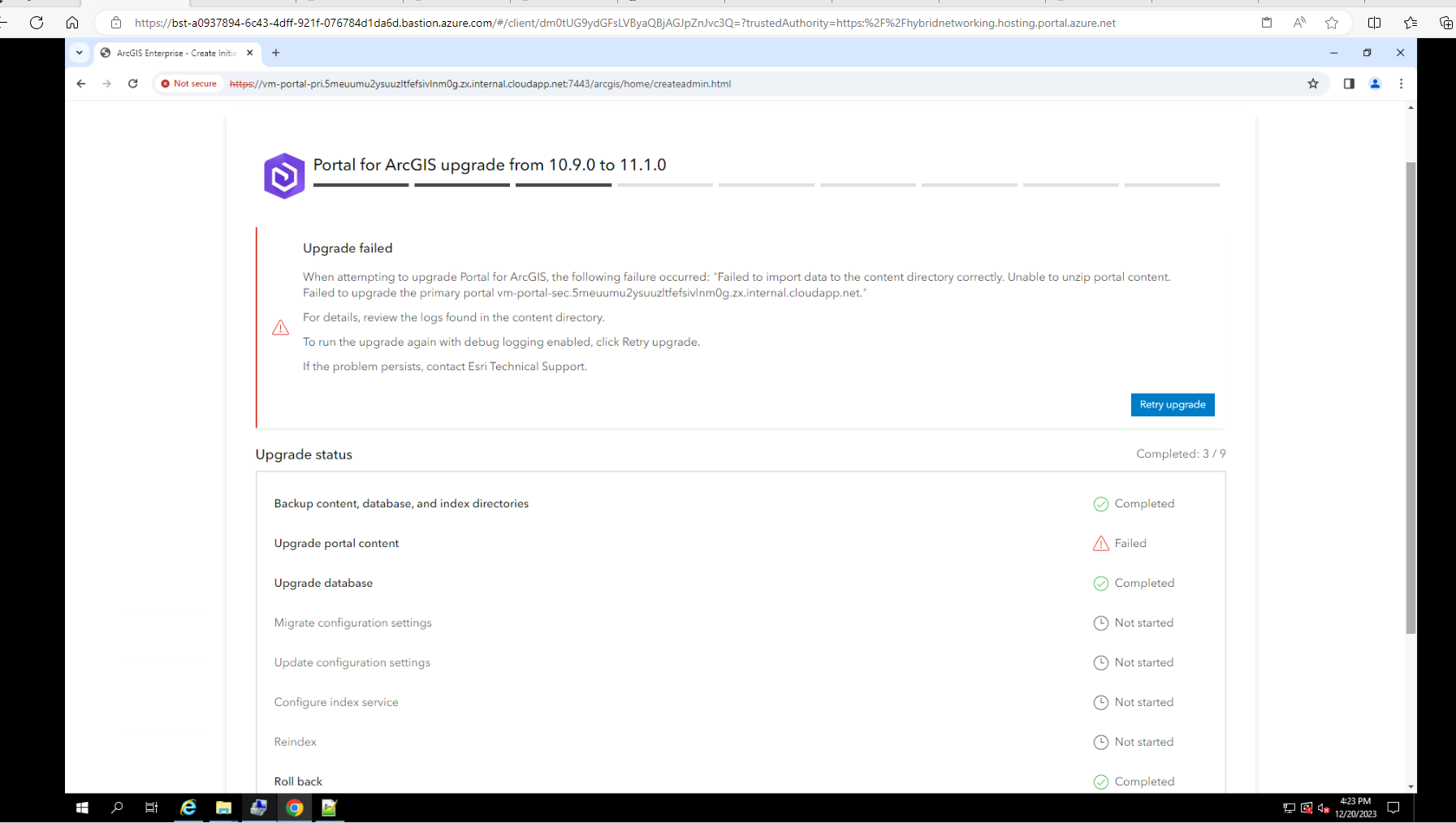

The upgrade then obviously failed with error: Failed to import data to the content directory correctly. Unable to unzip portal content. failed to Upgrade the primary portal (then gave the standby portal name).

In one of my previous attempt, if the standby machine is not running the service then the step 8 was missing (Upgrade standby machine).
