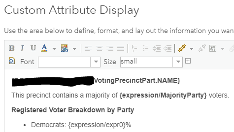

But when I add it into the pop-up:
The value doesn't display:
OK, fine. So I publish it as a Feature Layer and turn off editing capabilities. Now my custom Arcade symbology and my pop-ups don't work.

There is something that I noticed about the way you reference the Arcade expressions in the custom HTML pop-up. One expression that does not work is addressed using the index "{expression/expr0}" the other that does work is referenced using the name "{expression/MayorityParty}". How did you add the arcade expression to the custom HTML? Did you type it in or use the "+" sign?

The {expression/MajorityParty} came from the settings in ArcGIS Pro. I published the layer using the Share as Web Layer tool, and since I had the option to create an alias in Pro, I did. There does not appear to be a spot in the Portal configuration dialogue box to specify an alias for custom expressions. With my first attempt, I published all of the custom expressions (including the one that is causing me problems) directly from Portal. When they weren't working, I deleted them and recreated them manually in the Portal web map to see if there was a bug in their transfer from Pro to Portal.
