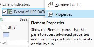

in order to set transparency on the extent. Select the extent indicator, right click, and select propertiesselect EI.JPG

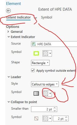

In the Extent Indicator Properties (element). Change the Element from "Leader" to "Extent Indicator" select "Callout to Edges" and choose the "Symbol"
Select the color again.

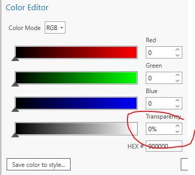

In the color properties choose transparency.
Make your change!!
