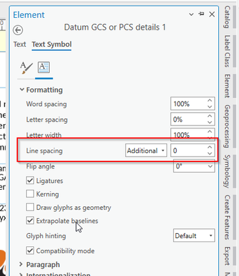

SarahBenson
elements tab for the text box you are wanting to edit
