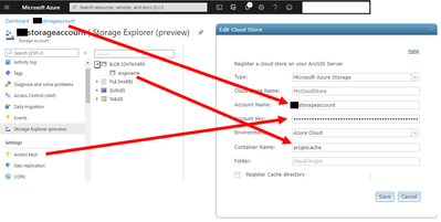

The documentation suggests you should provide the name of your Microsoft Azure and the Account key to access it, before you choose the Azure environment where the storage location exists. Something like this perhaps.
https://enterprise.arcgis.com/en/portal/latest/use/add-items.htm#ESRI_SECTION2_39B2CCBE12CA4F269E3EA...

After entering the provider, account name, and key, the environment drop-down remains blank

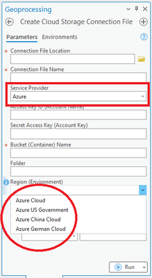

Please try this in ArcGIS Pro, ideally version 3.1.0, you do not need to be connected to any Portal.
From Analysis > Tools > search for Create Cloud Store Connection File, and open that tool. Only select Service Provider "Azure", what options are you then offered in Region (Environment) ?

@ChrisUnderwood the options are displayed when connecting via ArcPro (3.3), however that only creates a connection file isn't?
