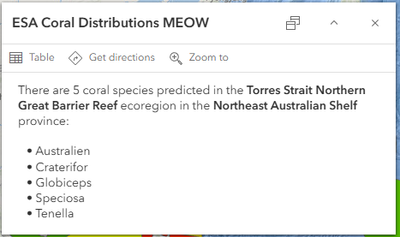

This is one way I do it for a particular map. The layer has a table with fields for 15 different species, along with other fields to describe the feature's location. For each species, the field name is MAX_Species (MAX_Austra, MAX_Crater, MAX_Globic, etc) and the alias is Species (Australien, Craterifor, Globiceps, etc). Each field contains either a 0 or 1 to show if the species is present.
I use this script in a Text element
Expects($feature, 'MAX*')
var theSchema = Schema($feature);
var fields = theSchema['fields'];
var species = [];
for (var i in fields) {
   if (Find('MAX', fields[i]['name']) > -1 && $feature[fields[i]['name']] == 1) {
     Push(species,fields[i]['alias']);
return `• ${Concatenate(species,'\n• ')}`;
which returns this popup
