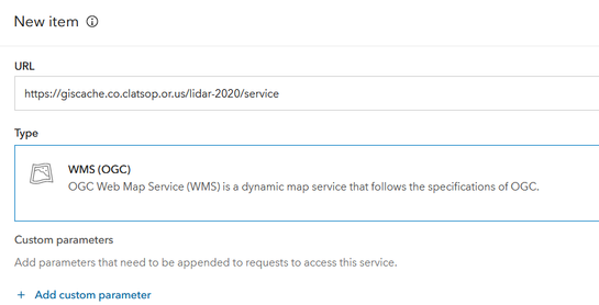

Here is the "New Item" dialog (for a different service), you need the URL and to pick the type WMS.

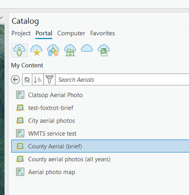

Here it is in the Pro catalog

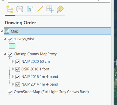

Here it is in the table of contents
