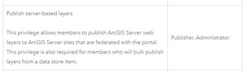

We have users that make maps using desktop software, which are then published to our portal (federated environment). Their publishing rights are controlled through publisher roles that are configured within the portal site. When they publish services, they have the ability to publish anywhere on server - which is explained in this server documentation:
"If a role's type is set to either Administrator or Publisher, that role automatically gets implicit access permission to all GIS web services hosted on the ArcGIS Server site. This implicit permission cannot be overridden by changing the permissions on a service or folder."

Thank you for your post! We now support the ability to create custom roles with which you can assign more fine grained privileges to users. If these custom roles do not address your specific use case, please post a new idea with details on how we can improve!

I agree, this would still be a very useful capability to have. Custom roles have been around quite some time, though they have gotten more fine grained they don't allow restriction of publisher users to create folders for server based services.
You can restrict users from publishing to entire servers, by changing the server role, but not from publishing anywhere / creating folders on the server.
