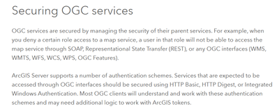

The ability to secure OGC services is present within ArcGIS Enterprise. Refer to, https://enterprise.arcgis.com/en/server/latest/publish-services/windows/ogc-support-in-arcgis-server....
However it appears to be limited and not include SAML/OpenID as per https://enterprise.arcgis.com/en/server/11.3/publish-services/windows/ogc-support-in-arcgis-server.h... :
Services that are expected to be accessed through OGC interfaces should be secured using HTTP Basic, HTTP Digest, or Integrated Windows Authentication.

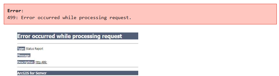

Additionally, in a fresh 11.3 ArcGIS Enterprise deployment, signed in as the primary site administrator I get a 499 error on the Sample World Cities WMS and OGC Feature layers as described here: https://support.esri.com/en-us/knowledge-base/error-499-error-occurred-while-processing-request-0000...
This is resolved when sharing all the layers publicly.
Can you please confirm the exact sharing/security settings that work with OGC layers. In addition please enhance the error reporting to explain if a layer needs to be shared in a specific way to work, so the user doesn't have to google html response codes.

A couple of thoughts on this.  If you want to secure an OGC layer, the recommended way is to publish it to an ArcGIS Server that is not federated with a Portal.  In addition, this ArcGIS Server needs to be configured with web-tier authentication (Basic, Digest, IWA, or client-certificate auth).  When an OGC client tries to access the layer, they will be prompted to enter credentials (or provide a client certificate) prior to gaining access.  This should work.
The problem with other configurations (Server federated with Portal or Server configured with non-web-tier authentication) is it utilizes token-based authentication and most OGC clients do not know how to handle that.  The 499 response code that is returned when trying to access a secured OGC layer is only understood by ArcGIS clients.  There is not a comparable response code that I'm aware of that indicates to an OGC client that an OAuth2 access token needs to be generated and used to access the OGC layer.
There are a few OGC clients that can handle generating and sending an access token (QGIS and FME are  two I can think of), but it is not part of the OGC spec so I don't think there are many others.  This is why we document that OGC layers need to be open and shared with everyone or secured with web-tier authentication to be accessible.
