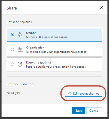

For some context, in ArcGIS Enterprise 10.8.1, when sharing from the Item Description page, clicking on "Edit group sharing" (seen below) will bring up a panel where all available groups can be seen in a single list, or filtered as needed:

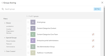

Thanks for your clarification here, this is very helpful. If you are using ArcGIS Enterprise 10.7, I believe I have some good news in reporting that this experience should be addressed in our latest version. My screenshot in the above post shows the new sharing experience from the Item Description page in 10.8.1.
Below, I've included a screenshot which shows the Group Sharing pane which appears after you click on "Edit group sharing." Compared to ArcGIS Enterprise 10.7, this pane shows the full list of available groups. I'm also able to sort through my groups, where I can specifically filter for "Special Groups" such as Administrative Groups (new in 10.8), Groups with Shared Updates, and Featured Groups:
I hope this information helps. Since this exists in the latest version, I'll go ahead and mark this idea as "Already Offered" for now, but please let me know if there's any other questions. Thank you!
