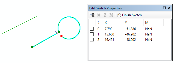

In the meantime, I wonder if this would be a possible workaround:
1. Create a field in the feature class called HAS_CURVES.
2. Populate the field in real-time/when a user creates or modifies a feature -- using a Calculation Attribute Rule.
  • Compare $feature.shape_length, which is the true length, including true curves
    vs.
    Length($feature), which is the pre-densified length, where true curves have been converted into straight segments.
    https://i.stack.imgur.com/ilJrg.png
  • If there is a difference between those two values, then that tells us that the line has curves. Use a Calculation Attribute Rule to set the HAS_CURVES field to "Y".
3. That field would be available to SQL. So we could query on it as needed.
Disclaimer: It's possible that comparing the those lengths might not work in all scenarios (due to rounding complications, etc.). Testing would be needed. As the idea suggests, it would be a lot more robust to have a SDE.ST_HasCurves() function in ST_GEOMETRY.
