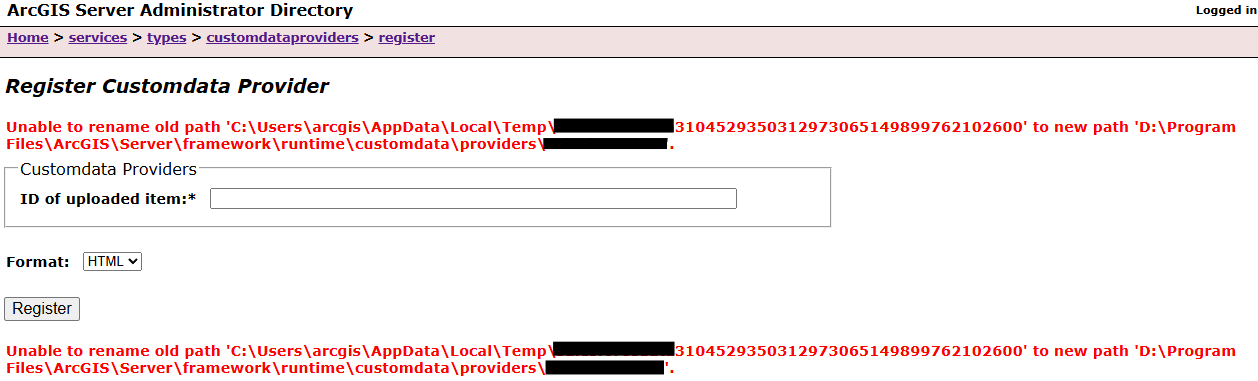

I loaded my CDPK file to ArcGIS Server admin directory, now I'm trying to register my Customdata provider and I'm being blocked by this error:
Unable to rename old path 'C:\Users\arcgis\AppData\Local\Temp\xxxxxx3104529350312973065149899762102600' to new path 'D:\Program Files\ArcGIS\Server\framework\runtime\customdata\providers\xyzxyz'.
I confirmed that our ArcGIS Server service account has full control over the providers folder here: Program Files\ArcGIS\Server\framework\runtime\customdata\providers. This error started after our upgrade from 11.1 to 11.5. I also get this same error when trying to register through ArcGIS Server Manager. I've tried this with a few different CDPK files and rebuilt a few Customdata Providers for 11.5  but no luck so far.

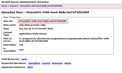

Have you checked the "Path on server" that your uploaded item has?

AJohnson_HFHI
Hi @GlenterpriseUK  Yes I can, utilizing the same Item ID shown on that screen when trying to register. Also yes, no issues when performing this on 11.1.

Hi @AJohnson_HFHI,
I was actually asking about your "Path on server" for the CDPK that you have uploaded is it on 'C:\arcgisserver\directories\xxxxxx or is the path' showing 'C:\Users\arcgis\AppData\Local\Temp\xxxxxx3104529350312973065149899762102600'

AJohnson_HFHI
Hi @GlenterpriseUK
I understand sorry, my path on server is: D:\arcgisserver\directories\arcgissystem\arcgisuploads\admin\xyzxyzx, similar to your screenshot.

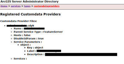

The other thing that I'm noticing now is that, although it's giving the same message about unable to rename folder, it does show the item as a Registered Customdata Provider when I refresh the browser. However, at this location, the providers folder is still empty: D:\Program Files\ArcGIS\Server\framework\runtime\customdata\providers
