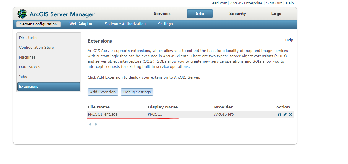

and added extension file in server manager extension as below screen.

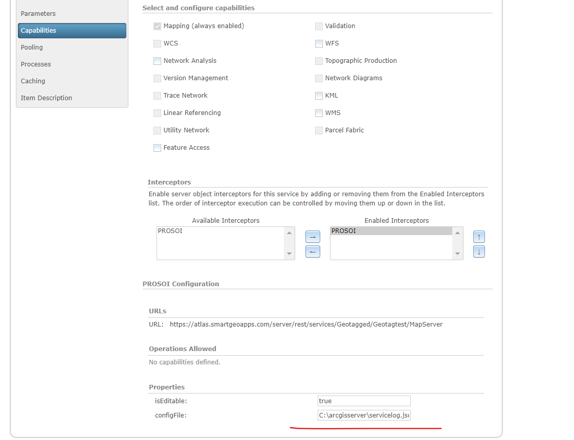

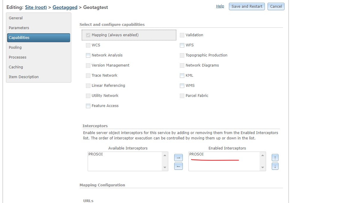

And enabled interceptor in service capabilities interceptors section as in below screen
But we are unable to see the logs in server logs who opened the service like username
Ans also we have enabled for write the logs in JSON file in service capabilities but it is not writing into that file

see this sample arcgis-enterprise-sdk-resources/Samples/dot net/SOI/NetSimpleLoggerSOI at master · Esri/arcgis-enter...
Anyway in the log you see the level you have enabled. If you set 'warning' you don’t see 'info' logs but only error and warning.
