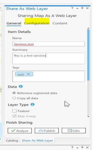

1. Publish a service and apply configuration in Dev
This step is a typical step for service publishing.
Opening an ArcGIS Pro project file -> Publish web layers
Note: In this step, try to set Configuration here(see the screenshot below) as much as you can, as all the Configuration set here will be saved into SD file(.sd) which will be brought automatically into other environments.

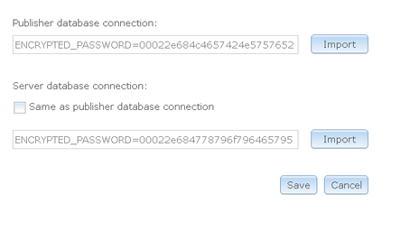

3. Register datastore
Now, we got a SD file from Dev but the database connection in this SD is still pointing to the Dev database.  ArcGIS Server provides a mechanism that automatically replaces the publisher database connection with the server database connection when the service starts, as long as the publisher/server database connection registered in the ArcGIS Server of Sandpit in our case:

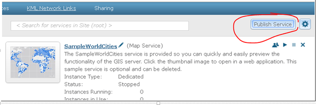

4. Re-publish the service in Sandpit
With the generated SD file, and the datastore registered, we can replicate service in Sandpit by log into ArcGIS server manager and choose to publish service.
So the service and the configuration settings are picked up automatically in Sandpit.
