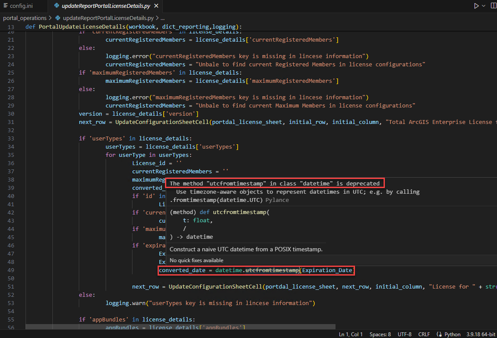

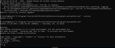

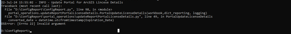

I'm running into the following issue when attempting to run this tool against my ArcGIS Enterprise 11.2 environment. 2024-07-22_10-57-54.png2024-07-22_10-57-54.png
After viewing the source code in my VS Code instance, it appears the tool is trying to use a deprecated method within the datetime class:
I've tried to use the python.exe in both the ArcGIS Server default location as well as ArcGIS Pro, however, it is giving me the same error message with both. The arcgis python api version is 2.2.0.1 in both scenarios.
RobertHadsellESRI_0-1721666736834.pngRobertHadsellESRI_0-1721666736834.pngRobertHadsellESRI_1-1721666763095.pngRobertHadsellESRI_1-1721666763095.png
Any help/insight would be greatly appreciated!

@RobertHadsellESRI An updated version of the tool has been published on the Knowledge Base article that should address this issue.

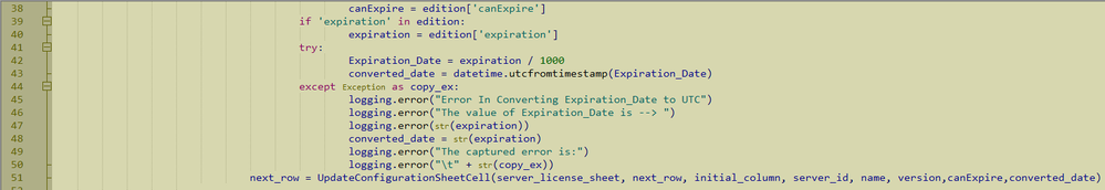

It looks like some try-except blocks where Expiration_Date is set may need to be indented in updateReportServerLicenseDetails.py. I was getting "local variable 'expiration' referenced before assignment" errors from the script. I indented a few of the try-except blocks and the script ran successfully.
Here's an excerpt showing one of the try-except blocks before I indented it:
MaggieBusek
@StephenM01 Thank you for your feedback! This should now be addressed in a recent update of the tool available on the Technical Support page
